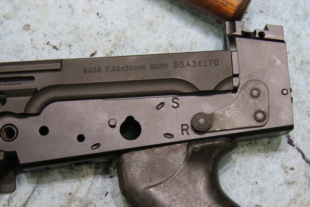

Having to massage the rear locking tab on the upper so the upper closes all the way but I figured there would be some hand fitting.
Its locking but the take down lever is not going all the way down so a bit more filing will have to be done.
The take down lever is NOT supposed to "go all the way down" on a new receiver! There's supposed to be some margin for wearing in. Read thru this whole thread : Not closing 100%
The correct position of take down lever is shown in this pic:
