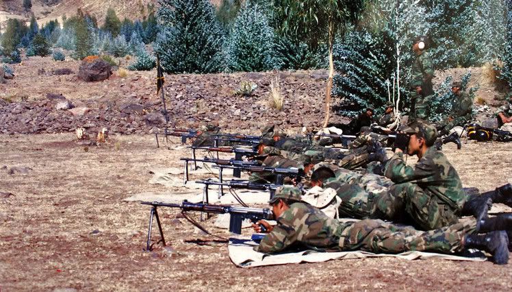

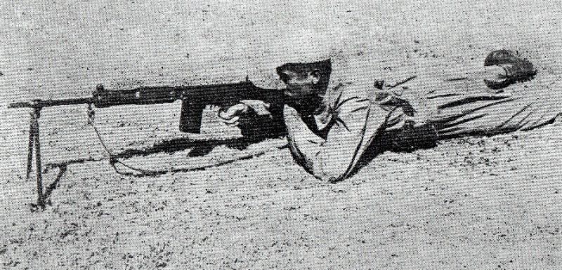

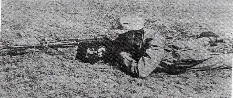

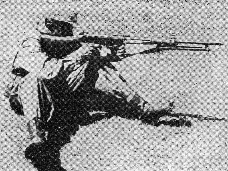

Those pictures were obtained from an argentine army field manual published in 1960, they show the use by our soldiers of the early version of the FN made FALO (FAL LOURD - Heavy FAL) also known in spanish FAP (Fusil Automático Pesado), I dont know yet if the FMAP made under license the FAP in this configuration.
The color picture shows a group of peruvian infantrymen shooting their FAP´s in a range, I count at least four or five earlier version FN FALO´s (see Blake Stevens page 267, figures 229 to 232).
I hope to get a pic of the venezuelan FALO in wich is very rare, I found many pics of the Chavez´s Milicias Bolivarianas armed with FAL´s, but not with FALO´s yet.

Those are very nice pictures FSL! Any idea of the year were taken? In 1973 during my Military Service I saw many FAPs but were the later style with the short wood handguard and never saw the early style or the ones with the FALO black plastic handguards......
