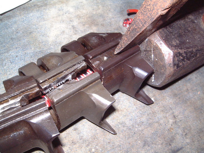

never did the opposite-side cut as recommended above but would've had i heard that before. still was no problem. i now have the proper clamping devices so it's a moot point for me.
here's a pic.

What the Dremel-cut looks like before splitting - you can just faintly see the barrel-threads inside the cut (dark vertical stripes):

That's an excellent pre-split pic!

Attached for posterity
